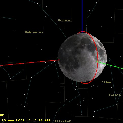

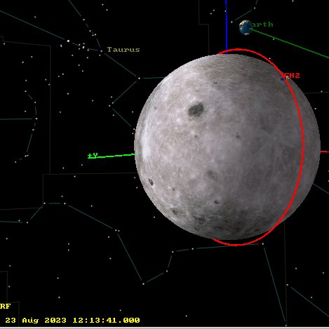

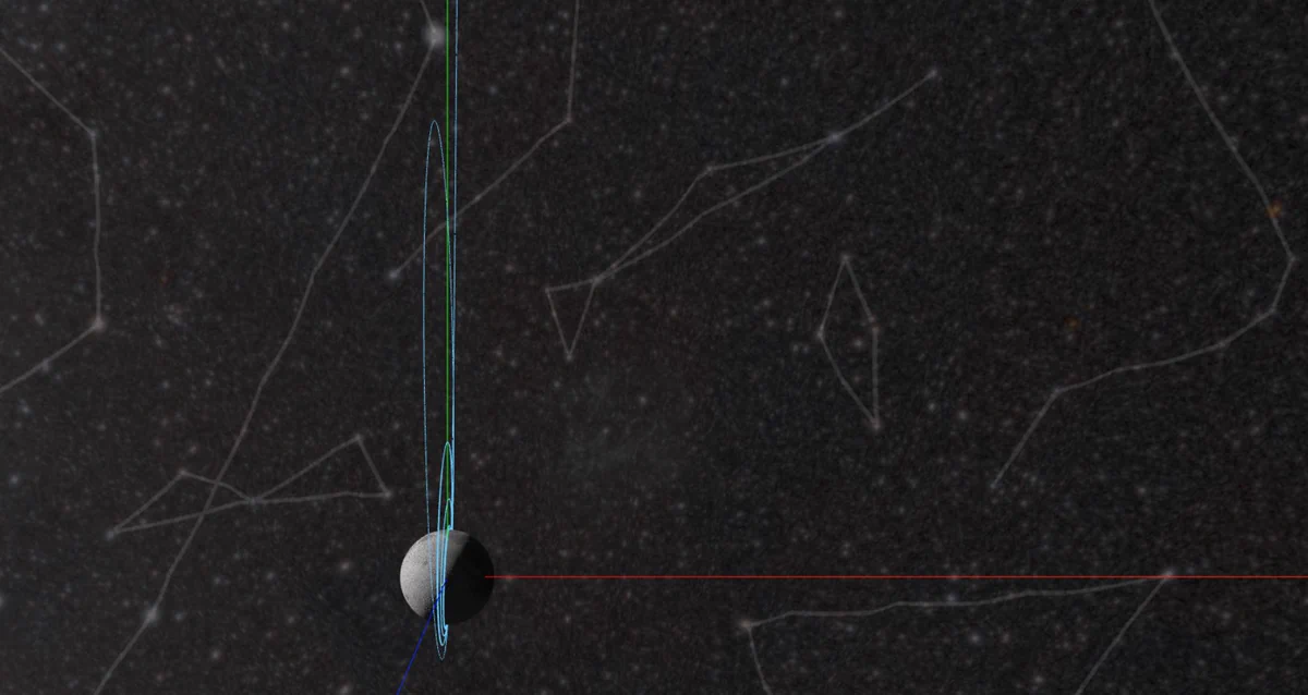

Okay, decided to some fun calculation and put some basic figures to show/understand the orbits of CY3 PM (Propulation Module), CY3 (Lander, Vikram) and CY2(orbiter).
Most people use ecliptic coordinates, or Earth's equatorial coordinates, but for following I am using Moon as the point of origin - How things will look from Moon:
Basic Math (and may be some trigonometry) is all you need to calculate relative position of CY3PM, CY3, CY2, Earth, Sun from the point of view of the Moon.
Origin: Moon Center. (Radius of Moon = Center radii 1737.4 km (To calculate altitude, subtract this from distance)
XY plane - Moon's Equator (This is within 1.5 degrees of ecliptic - so if you use figures from my previous post, will be almost ok)
X- Axis - points towards vernal equinox (Moon slowly spins -- 27.33 days for 1 rev -- so wrt to Moon's surface, this direction is not fixed)
Epoch: August 21, 2023, 00:00:00 UTC
Orbital Plane:
Inclination of CY3PM = 89.4 deg of CY3 = 89.3 deg , CY2 = 90.0 degrees ==> All orbits are almost polar.
Ascending Node: CY3 (PM and CY3) = 270 degrees, CY2 = 268 Degrees.
(Both orbits are almost in the same plane - within 2 degrees)
e (eccentricity) : CY3PM = .004 CY3 =.002 , CY2 = .0015 ==> All orbits are nearly circular ( Easy for calculation)
Perigee CY3PM -> 1888, CY3 ->1769 CY2 -> 1818 Km (To find altitude subtract r= 1737.4)
Apogee CY3PM -->1901 CY3 -> 1864 , CY2 -> 1871 Km
Semimajor Axis = a = CY3PM -> 1894.5, CY3 -> 1816.8 , CY2 --> 1871 Km.
This gives period in seconds CY3PM -> 7402, CY3 -> 6949, CY2 --> 7111 seconds. (1 Hr = 3600 seconds)
(IOW: CY3-PM period is 123 Minutes, CY2 is 118 Minutes, while CY3 lander is 115 minutes.)
(This is useful in calculating velocity at any point in the orbit.
𝑣²=μ(2/𝑟 −1/𝑎)
𝑇=2π √(𝑎³/μ)
μ for moon = 4.905×10¹² ... in SI units)
(So you can calculate velocity of CY3 at any given altitude)
Location of the primary landing site: 69.367621 deg. S, 32.348126 deg East
This means: Earth is almost fixed: About 20 degrees from horizon -- will move about 6 degrees above or below this number within 14 days (or 1 Moon day - On August 21, this angle is about 14 degrees from horizon.)
Sun will rise and set within these 14 days - Sun never going higher than 20 degrees above the horizon (at "noon" at Moon - 7 days after landing)
Position of CY3PM and CY2 orbiter can be calculated knowing both space-crafts are moving in almost circular polar orbits,
(One thing I calculated and noticed: CH2 and CH3PM are orbiting in such a way at least one of them will be in visible/radio range from CH3 around most of the time during those 14 days.. at time of landing both of them..)
Hope this is useful.

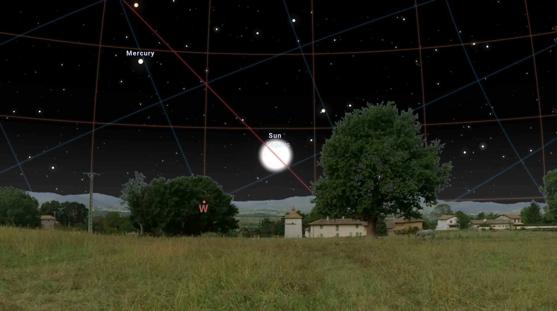

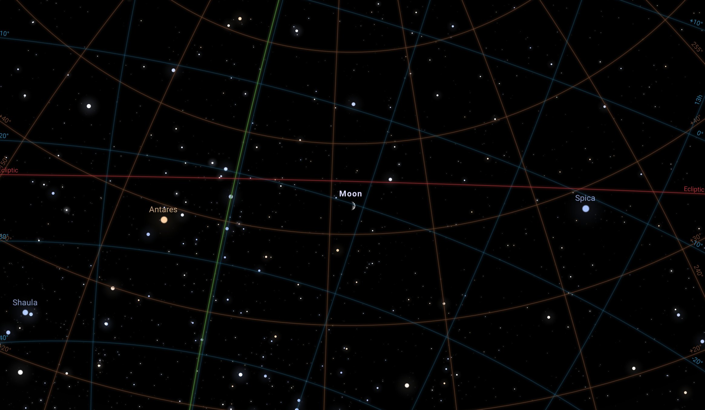

Decided to point my telescope from the resting point of Vikram-1 (CY2)... I heard that they are sending Vikram-2 on CY3 from that blue planet... Not too long to wait...
(Image AmberG - Star positions are mathematically correct at the time specified - as I post this post..)

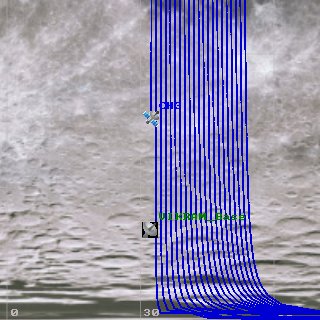

Some comments on the ISRO's recent video/photos: (Points highlighted)
Mare Maginis: lies on the very edge of the lunar nearside
Mare Smythii: located along equator on easternmost edge of Moon's near side.
Ibn Yunus: remains of a flooded lunar impact crater
Craters visible from the side from Earth :Jansky F & Goddard: Crater, also visible from side of Earth
Hirayama: large lunar impact crater that is located on the far side of the Moon
Brunner: crater is located close to Mare Smythii.

For family and friends I will do some live commentary...So sharing..
In Ohio, (and in California).. Moon would be below horizon (About 33 degree where I live).. but in India..train your telescopes/ radio telescopes at around 6:30 PM tomorrow.. Moon's RA will be around 15Hr,05 Minutes and Dec = -20.15 degree... that's about 43 degree above horizon in Udaipur, Rajasthan and 198 degree Azimuth)
So if you look towards Sun (From my home-town Udaipur) or Moon , here are the sky maps:
Of course, if you look from the moon, All Brf posters location would look something like < (I posted the image before)

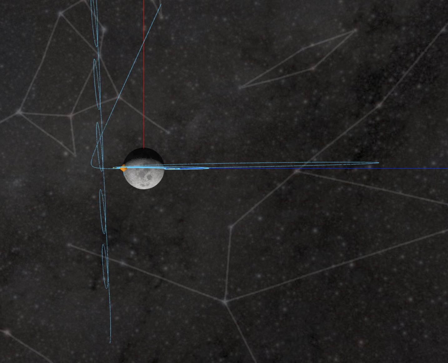

As I post this (August 22, Time: 8:42 UTC) Vikram is 43.5 Km away from the surface moving at 1.67 Km/Sec wrt to the Moon.
This is 387,976 Km from earth (Velocity 1.01 Km wrt to Earth)>

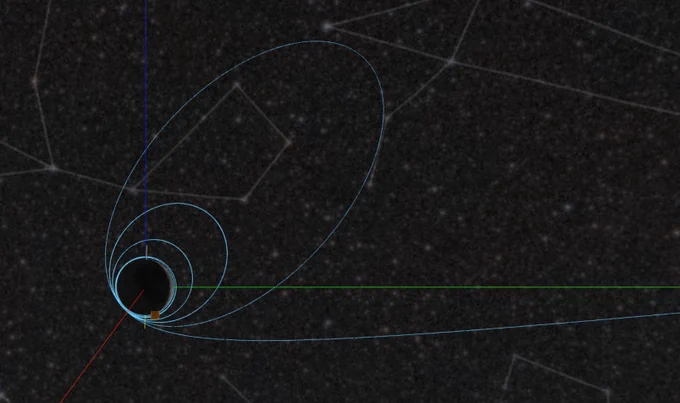

Here, From Sankara's Animation, Orbits in XY, YZ and ZX Planes, to understand the past orbits at the time of Landing.. Then the distance from the moon is 1734 Km - giving altitude = 0, Velocity wrt the moon = 0, All went well.
XY - Plane - Z axis is coming towards you from the screen.
YZ Plane:
Z-X Plane:
YZ Plane:
Z-X Plane:

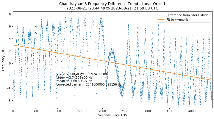

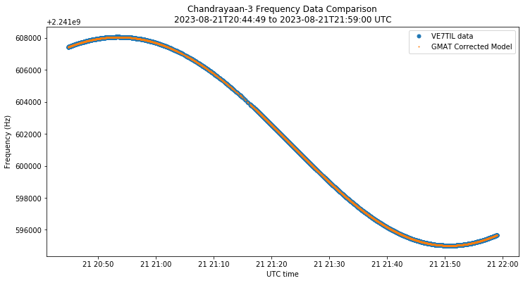

Good info from Scott Tilley.
https://twitter.com/coastal8049/status/ ... 6243188209
#Chandrayaan3 (and family) trajectory update for 2023-08-21.
Landing is over a day away. Doppler modelling to the orbits of CH2 and CH3_LM is very good now.
Let's look at the details of the landing based on the orbits and see how it all comes together.
#Chandrayaan3 lander's orbit is very well described by the Doppler data. The residuals are very low and the wobbles you see in the residual plot are artificial and introduced by the ground station. The final orbit is precisely known now allowing landing timing estimates.
Propagating the orbital state vector for #Chandrayaan3 until the perilune before the landing places us here vs. the landing site at about 2023-08-23T12:13:41 UTC. The lander needs a little over 14.5 minutes from beginning the sequence to land. So it looks about right.
Meanwhile what is #Chandrayaan2 up to? How will it help?
It will be positioned antipodal to CH3 at the time of the landing attempt. It's role in the mission appears to be support after landing as it will pass over the site just after the landing is completed. Makes sense.
