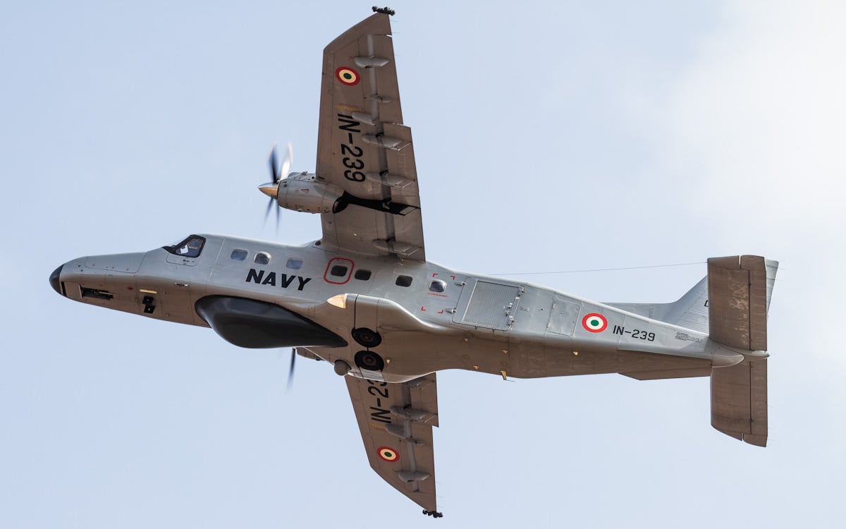

Regarding Dorniers, only Indian Navy and Coast Guard Do228 use Israeli 2022 and can detect ships and boats and limited SAR for ground topology but cant detect trucks vehicles etc. Which is why it carries the EO sight with CCD Day Camera and IIR for night/bad weather. Both Elta Radar and EO sight are visible in the photo below.
