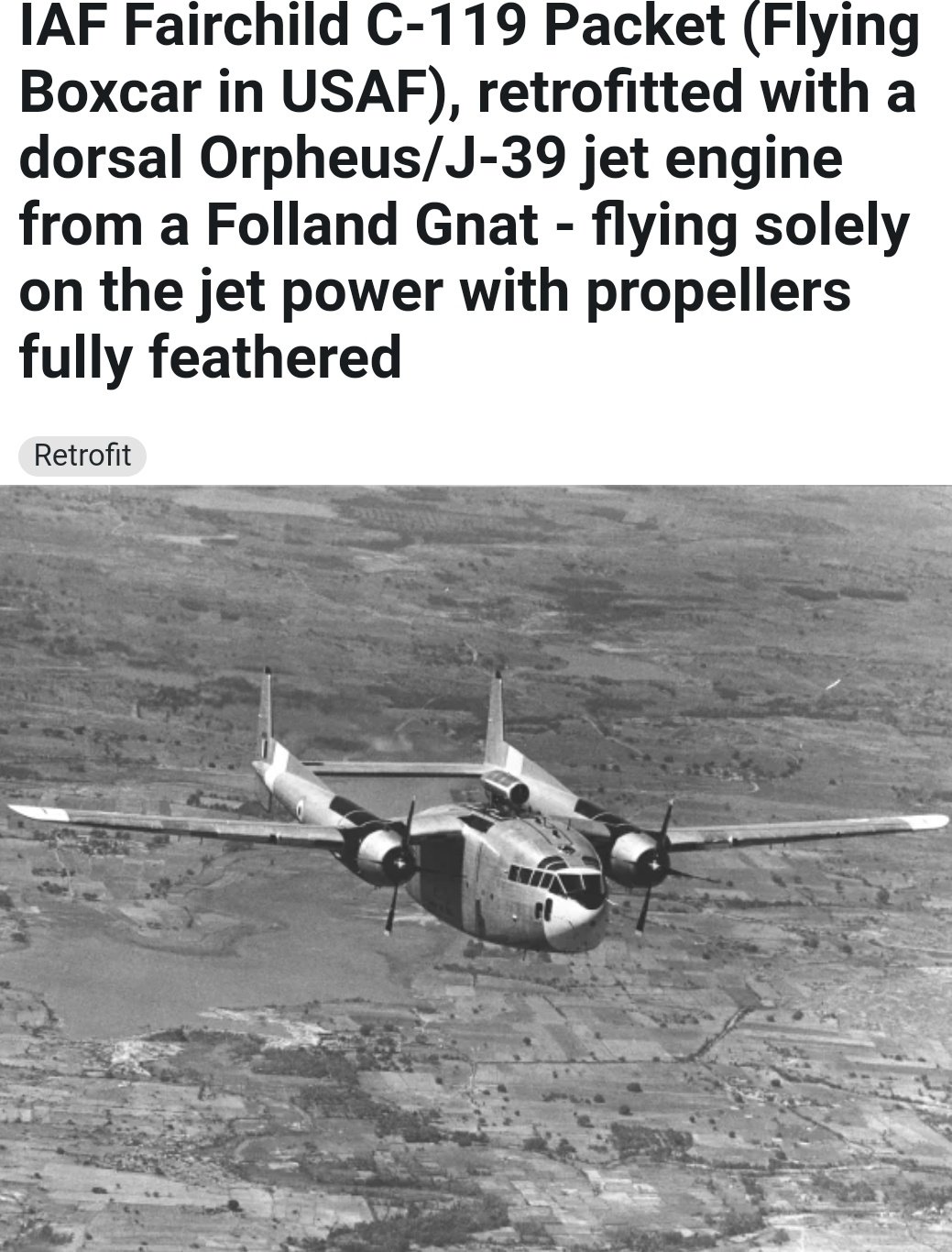

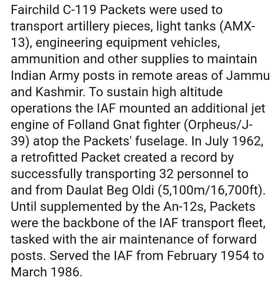

Posts: 21747
https://x.com/FighterPiloting/status/18 ... 9936007456 ---> 1962 photo of Indian modification of additional 22kN jet engine retrofit on IAF's Packet aircraft. Flew like this till 1980s. Similarly, 53kN Kaveri can be fitted on IAF's IL-76 any day. Unless Indian engineers of 1960s were better than Indian engineers of 2020s.
Rakesh wrote: 25 Sep 2024 19:04https://x.com/FighterPiloting/status/18 ... 9936007456 ---> 1962 photo of Indian modification of additional 22kN jet engine retrofit on IAF's Packet aircraft. Flew like this till 1980s. Similarly, 53kN Kaveri can be fitted on IAF's IL-76 any day. Unless Indian engineers of 1960s were better than Indian engineers of 2020s.
That's entirely possible -- much less exam cheating back then.
India is missing a live testbed aircraft and IL-76 would be ideal. Russia has a similar setup and they tested the Kaveri on an IL-96. Why the babus of MoD are not sanctioning an effort for a live testbed - beats me in terms of logic. The only way to fine-tune the Kaveri is by live testing with real-time data feed. That is how GE does it for all their engines. They have data live streamed from all their Jet engines worldwide. Data on every component is known to them so that they can fine tune each and every component. GTRE has to graduate beyond the rookie mistakes and work hard to turn Kaveri engine into reality. How many donkey's years are they going to take to get to proven working engine.
